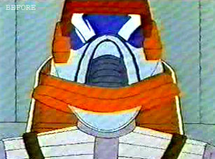

    There not horizontal lines i see (i should have chosen my words better), it looks like this:

    You're seeing a corrupt tv signal. That MASK image is a 1980s tape, poorly converted to VCD.
    The noise is a form of herringbone (though that's normally just horizontal).
    Only way to fix that is to fix your wiring.
    Or if the source is no longer available, restore it. It took me a few weeks to get perfect filters setup (in my free time) to fix that stack of discs.

    Looks like a ground loop problem. need to make sure everything is grounded proberly. Computer, VCR and cable need to be grounded.

    hate to bump topics but...is the source from cable? if the channel is below 120, your cable provider needs to be contacted...something is wrong with the cables that lead into your house (any channel below 120 is still analog, and noise is only prevalent in analog signals...digital signals break up). if its over-the-air, i suggest either a better antenna or going dish or cable. i record everything on TV with that kind of noise...i live outside of DC, where there is a huge population boom...buildings block my signal everywhere. therefore, i always get noisy over-the-air TV. igh:
