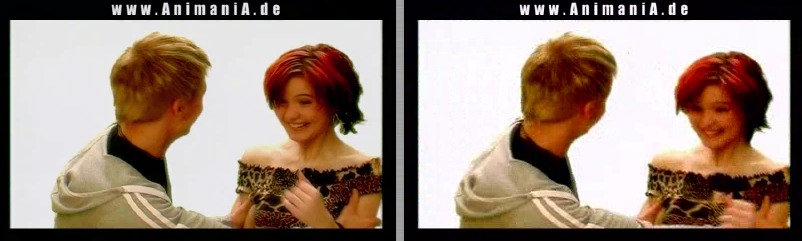

    No this greentouch presists always no green frames or something. Here's a sample picture. I've encoded a .mov to divx .avi using the ffmpeg engine. The left picture shows the origina and in th right picture you can see this slight greentouch.
    Belgium
    Sorry but i don't see the greentouch...
    If i take a 5x5 points sample in the background:
    LEFT:
    R=230
    G=230
    B=230
    RIGHT:
    R=251
    G=248
    B=254
    So it's more magenta...
    I can't help you... sorry..

    I don't use this technical stuff to discribe a picture. I trust my eyes and what i see. Everyone i asked about this said that the right picture has a slight greentouch. Don't you see this by yourself? Trust your eyes!
    The only thing i wonder is why? Why doesn't ffmpegX produce a picture with the same colours as the source? Why change them?
    It doesen't matter what those test tools results are, the eye can see the difference very clearly.

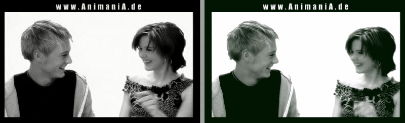

    I switched my test movie to black/white and encoded it again. If you don't see the greentouch now then you must be blind.
    Belgium
    I'm not blind
    It's more visible on the B&W.
    Remember that ffmpegX is just a GUI, so maybe try with an other application that use ffmpeg engine to be sure that's a ffmpegx's problem.

    Sorry for the blind stuff. I'm aware of it that ffmpegX is just a GUI. But the same happens when i use the mencoder engine. When i use mencoder for itself, there's no greentouch. Also the mpeg2enc engine doesen't produce this green stuff. Witch tool uses the ffmpeg engine too, so i can test it.
