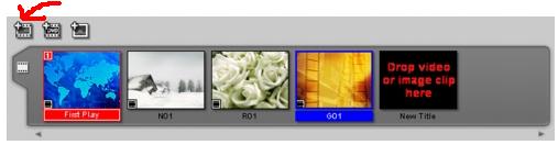

What's your source? If you've already made an .MPG2, import it directly into DWS2. If you have DV or other .AVI, use TMPGEnc to make a good .mpg 2 DVD file (see these guides), then import that into DWS at the Edit page by clicking on the button I've illustrated. You can then create menus and everything.

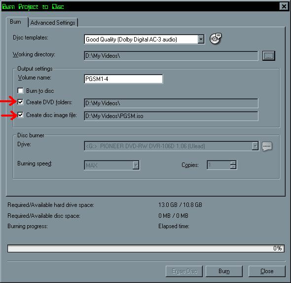

When you say you preview your file, how and when are you doing that? Before Media Studio Pro, after it or in DWS2's preview? There is a way to preview your actual final result without actually burning a DVD. On the Finish page, click on the Burn Project to Disc button, then in the Burn Project to Disc dialog box, uncheck Burn to disc, but check Create DVD folders and/or Create disc image file. When it's done, drag and drop the resulting VIDEO_TS folder into your software DVD player, for example WinDVD or PowerDVD, or mount your .ISO file with a virtual drive, for example with Daemon Tools.
The clips made with the various settings were made with MS Pro. I took all of them and inserted them in to DVDWS as separate "titles" and used the preview screen immediatley above that to preview.When you say you preview your file, how and when are you doing that? Before Media Studio Pro, after it or in DWS2's preview?
I never thought of that. That would be even better for seeing exactly what I would be getting when finally buring to DVD.There is a way to preview your actual final result without actually burning a DVD. On the Finish page, click on the Burn Project to Disc button, then in the Burn Project to Disc dialog box, uncheck Burn to disc, but check Create DVD folders and/or Create disc image file. When it's done, drag and drop the resulting VIDEO_TS folder into your software DVD player
