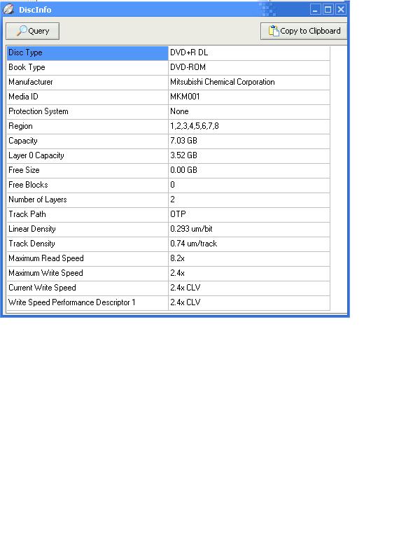

  25. I'm confused: Does the Liteon 832 bitset or not (at least w/o a hacked FW)? It looks to me like tommyoz's burn was set to dvd-rom. When that disk was burned did it just use the layer break from the original? I'd be hoping that DVDDecrypter will just let me rip & backup to DL (as their website states that it's DL ready) as easy as a SL can be done, now. Also, any possibility that the current +DL drives might be firmware upgradeable in the not-so-distant future for -DL as well? As it would be seem to me that if the laser can refocus for +, wouldn't it work for - as well?
    Like a flea circus at a dog show!

  27. Originally Posted by Madz
    Madz, Here is what DVD Decrypter says about the DL disc.

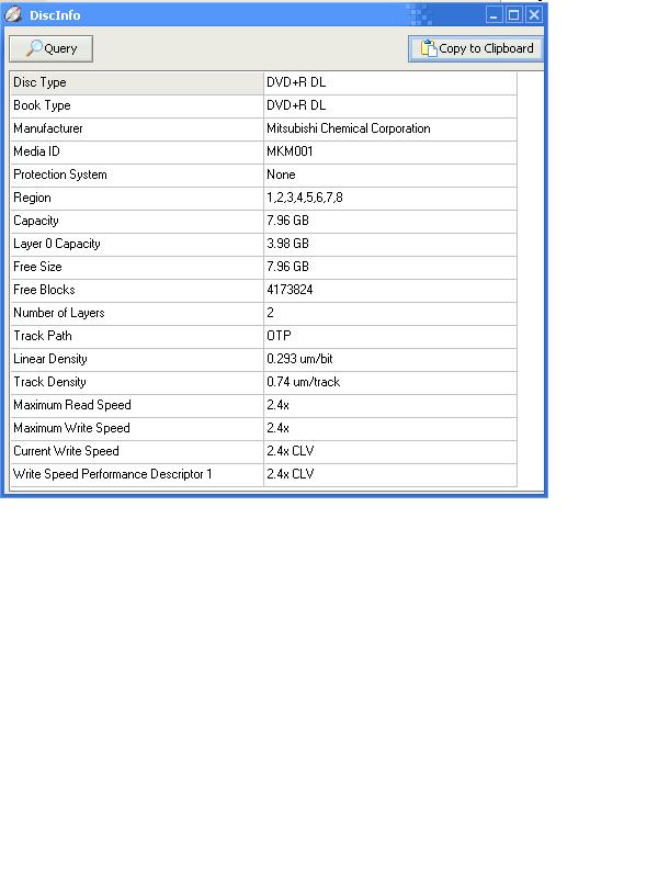

    Also here is disc info from kprobe from a blank DL media.
