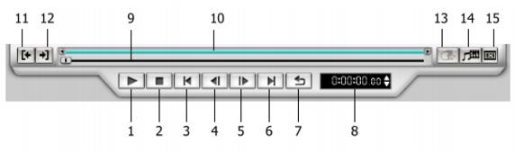

Ok, so I just got Ulead DVD Workshop 2. Problem I am having is after adding videos to the dvd list, the "Add chapter" button will not light up, so I cannot add anymore chapters. The one above that, that says "Auto add chapters" is lit up and works, but not the add chapters button. Anyone know what is going on? I am stumped!![]()

Well, you have to actually start playing (1) the video first, or use the jog bar (9) to get to a point in the video where you want to have a chapter start. Then hit the Add chapter button, which should be lit up.
Using the Go to previous I-frame (4) or Go to next I-frame (5) buttons is also a good idea for clean cuts.
ok, so say I have 20 mpg videos and I want to put 10 videos in chapter 1 and 10 videos in chapter 2. Do I have to cut out some of the video on video 10 to start chapter 2?
You want ten videos to play in a row when you click on a button? Drag and drop all ten into the Playlist for that button.
