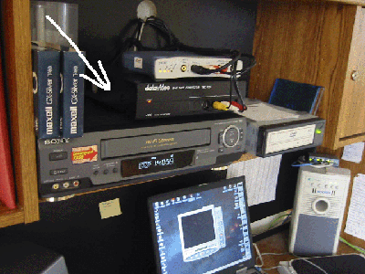

Thanks for your work on this; very interesting. One thing that bothers me, though... In any direct transfer an indistinguishable copy is one of my goals. The tools to remove noise, sharpen video, or remove hiss are cool, and may well be used 90% of the time. But are these defeatable? Because there is NO audio tool that removes hiss totally transparently, and a source may come along where the hiss is preferable to the anomalies caused by removing it. Same with video improvements.Originally Posted by lordsmurf
And has anyone put that LSI chip into a PCI encoder card yet?
C: Yes, you can edit the titles on the discs, menus look nice, attractive background, great highlights, clean fonts with plenty of typing space, I posted on image in one of the JVC review threads in the DVD RECORDER forum.
D: Yes, they appear to be very compatible, even with a player that normally rejects my discs not authored in ReelDVD (other software, it chokes).

Lordsmurf,
Thank you for your reply. I'm ordering both the DRM10SL and the Datavideo TBC-1000! That sounds great!
In response to Jester700, you said:
I looked at the reference, and the various boards. Do you have one that you recommend?Originally Posted by lordsmurf
Also, do you use Womble MPEG-VCR software to do your PC-based video editing?
Thanks again,
Dana
Womble MPEG-VCR and MPEG Video Wizard are both excellent frame-accurate MPEG video editors and do not re-encode (unless transitions or filters in Video Wizard are used). Both are lightning fast, too. Cuttermaran and MPEG2Schnitt (freeware) can do simple I frame cutting and joining without re-encoding, as well.
Yes, and I'm very impressed by its quality. I also owned Panasonic DMR- E60 and I'm totally agree with lordsmurf. Panny's 4 hours mode video quality is much inferior comparably to JVC. JVC also has much better block noise inhibit capability than Panny.Originally Posted by DCA_Guy
Alright!
I did it!
Based on the extensive input on this topic, and the assistance of many... I ordered my components, at the best prices & reputable dealers that I could find:
- JVC DRM10SL for $359.10 at GoodGuys
http://www.goodguys.com/adtemplate.asp?invky=168881&catky=
GoodGuys has a 10% discount off the posted price ($399) for online orders!
- Datavideo TBC-1000 for $279.95 at EVS - Express Video Supply
http://www.evsonline.com/merchant2/merchant.mvc?Screen=PROD&Product_Code=TBC1000
Thank you all for your assistance with this decision. I feel good about it. And, I can't wait to receive my new equipment!
Dana
