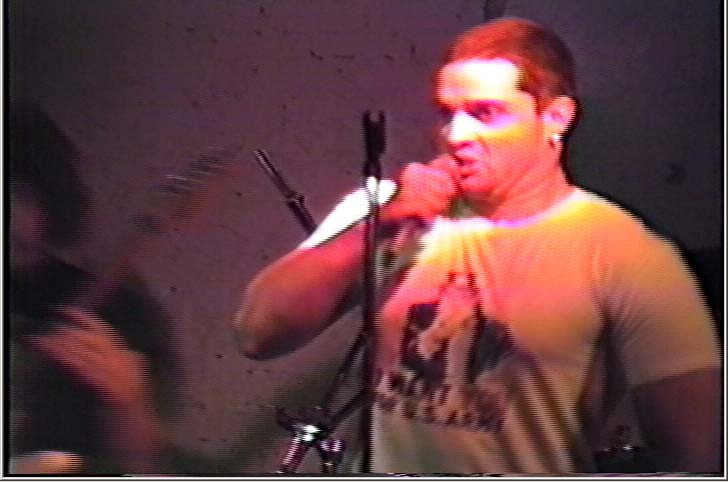

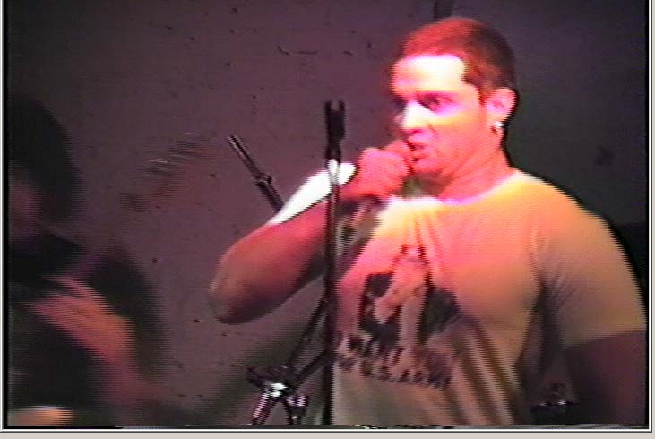

  1. The following two stills are from different VCRs (one SVHS and one VHS). These are untouched captures, but saved at medium jpg setting. Interlaced. No filters or sharpness applied to either of the decks.
    Which one looks like the better capture?

  3. Oops. A little clarification.
    The source video was videotaped in 1984 on a consumer Panasonic VHS Video Camera.
    I just meant, I captured the videotape to my PC using a SVHS deck for one of the pictures and a VHS deck for the other.
    I didn't mean to imply that the source was S-VHS, as it's only a regular VHS tape.

    Color of the top picture is closer to correct saturation. Both pictures look like poor quality composite video.
    A signal with proper NTSC chroma dot-crawl from separated video eliminates red-blue color fringing and lowers the smear of chroma noise. Can you use the s-vhs player to deliver an s-vhs signal to the video capture circuitry when playing vhs tape?

    Not sure what you mean.
    However, I used the S-Video cable from the S-VHS deck to the capture card and used the composite cable from the VHS deck to the capture card.

    Definitely Old and using maximal zoom from about 50-60 feet away. This is in a club and I had to shoot across the "pit".
    I know the difference are slightly insignificant considering the source material, but I want to decide which deck to dump and which one to continue using for now.

    Both look nasty but I guess the first pic looks better than the second pic.
    I'd rather not have to choose either though :P

    The top picture is a 5 year old Toshiba Consumer VCR using crap composite cables into Cap Card.
    The second picture is a 10 year old JVC S-VHS using S-Video cable into Cap Card.
    I was hoping using the S-Video Cable on the JVC would edge out the VHS deck using composite. I had my mind stuck on the connection and not the deck.
    Any one have any filter ideas to clean up this video? I tend to use Guava Comb (not necessary) and Convolution3D as well as Levels, but since the pictures are up... any specific help would be appreciated! :P

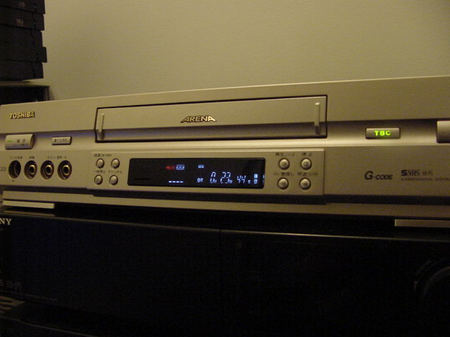

    Well Fulci, I don't know whether to agree with you or not on that one. Last week I stumbled across a Toshiba SVHS unit with a built in TBC and a 3D digital YCS and DNR. I found it in a "recycling" shop in Misawa Japan. It was pretty light in terms of weight (see also "cheap"), but at 12,800 yen (about $120), I couldn't pass it up. I've captured two VHS tapes that dropped hundreds of frames in minutes with my other VCRs. I can't find anything even remotely resembling it on the net. I can't tell how old it is but there wasn't a scratch on it and I got the remote and all the paperwork with it. Who knows.. If anyone has seen an "American" version of this, let me know:

    I think the second picture looks the best. You can see more detail in the facial area. The colors aren't as bad as the first pic.
    LS

    I think the top one has a bit more detail, particularly the bullet holes in the wall . Did you say the band was playing during the Vietnam War?
    It seems the top picture has a slight more (very very little) detail on the edge of his elbow and the text on his shirt. But overall I would say the top. It may be easier to work with the top video with filters in virtualdub. Where you will only be mostly concerned in sharpening the foreground for the most part as far as details go.

    The first Picture look better then 2nd Picture becuase the 2nd picture has more dots around more detail in the facial area I sure what some are look at.
