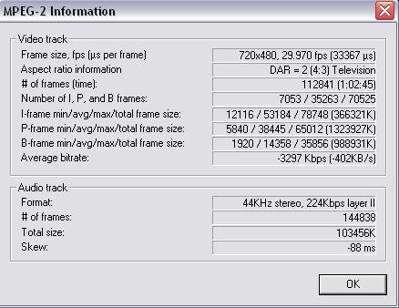

    Well, here's what VirtualDub says about my MPEG2 file. I'm trying Ulead Movie Factory again right now with this new info, thanks.

    Weird, my capture software (the WinFast PVR stuff that came with the card) doesn't give me a 44k or 48k audio option for MPEG2, only 224/240/244k etc. Which option should I pick to make my video files have a 16-bit 48k audio rate?

    Well, I tried capturing at the highest rate available for MPEG2 (384k) and VirtualDub still says its 16-bit 44khz audio. How depressing:/
