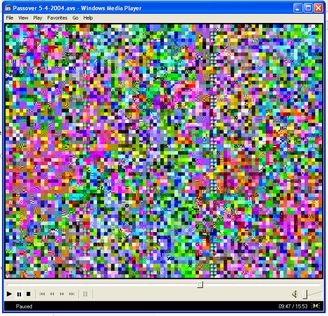

I'm using AviSynth + DVTimeStamp to add Datacode to my DV Files.
I noticed that when I using the AVS file I can see some "bad frames" inside my DV File (attached image), when I'm not using the AVS I don't get even one frame like that.
I tried to remove the DVTimeStamp and use the AvySynth just for reading the Avi file without changes and still, I get the "bad frames" in the file.
I also tried to download varios versions of AviSynth.
Can anyone help me ?

I have experienced the same effect when I import my DV files with avisynth. (Also other AVI types give sort of dropouts)
Virtualdub will open it without problems, mediaplayer (and other) give bad frames and audio corruption.
I can ALMOST eliminate the effect by disabling the hypertreading function of my P4. But it will not fix it.
The only solution I found is to disable the audio in my AVS script and process it separately.
Example:
This will give the me those bad frames:
SegmentedAVISource("hingisYi.avi")
This will work without bad frames:
SegmentedAVISource("hingisYi.avi",false)
There seems to be no real solution, it's really frustrating.

Hi everyone !
thank you all for the replies.
I can now use AviSynth without problem in two ways :
- Disable Sound process - (Thanks The_Doman !)
- I am using the command "DirectShowSource" instead OpenVMLSouece
(Thanks to Basilik Tournadski - TvTimeStampex author)
Now I can process without errors !
Thank you all.
