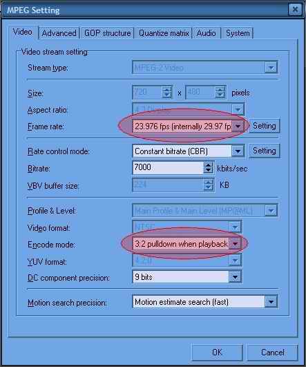

  5. Ok cool I've done that, and what I see is:
    Fps: NTSC 29.97fps
    Detected fps: FILM 23.97fps
    Im not sure which it is here... If its 23.97, does this mean I should use reverse 3:2 pulldown instead of interlace when converting? Or do I choose 3:2 in the advanced properties of TMPGEnc (a little confused about this process tbh)?

  6. Member teegee420's Avatar
    Dec 2003
    Southern California
    Let me preface by saying that this is just a theory of mine. I can't guarantee my suggestion will yield your desired outcome. That said, here's how I would set up TMPGEnc:
    As a side question, what would you use this Flask program for over any other?
    Before I discovered Virtualdub MPEG2 I used to use FlaskMPEG to convert mpeg-2 to DivX and XviD. It just so happened I remembered that it could detect 3:2 pulldown.
  7. Thanks, that looks like it would do the trick if TMPGEnc would let me change the framerate in that window you linked... ehehe.
  8. Oh no wait, I changed the "content of movie" to film movie and thats now given me all the values I need as per your post. Im off to try this now, I'll let you know how I got on :>
  9. It seems to have worked a treat! Thanks for the help teegee420
