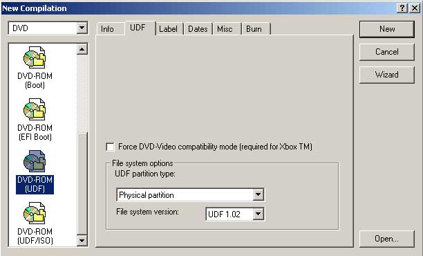

UDF 1.02?

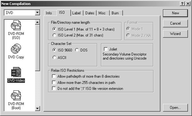

What version of Nero, and what settings? Video DVD, or "fixed" UDF settings? Have you used the same burning software for all of the good and bad discs?
EDIT: sacajaweeda, don't post my answer before I can post it. I'm reporting you for a temporal violation!

Setting is DVD-Video, as for UDF settings, I've seen nothing about UDF anywhere int he settings... its unlikely that that setting would have changed since my 1st burning, but poissible.. where would I find it?

I autually just found that, but when I chose DVD-ROM(UDF) and added files, Nero told me that the resulting DVD wouldn't create a DVD Compliant Disc and told me to use DVD-VIDEO instead...

One other thing .. when burning with nero under DVD-VIDEO settings, when burning theres a message at the top...
Compilation name: DVDVideop1_DVD (Mode1) UDF/ISO compilation -

DVD-ROM (UDP) didn't work.. still the same message, Incompatible Disc.
