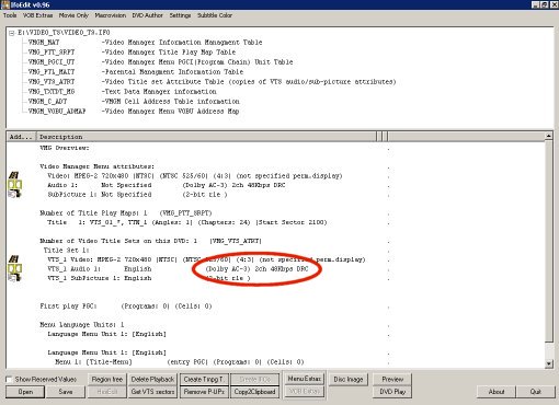

    Take notice of the audio stream(s) (circled above). If it says 6ch then it's 448kbps audio. If it says 2ch then it's 192kbps audio. If it says PCM, then it's 1536kbps audio. You'll need to know this for later, so write it down.

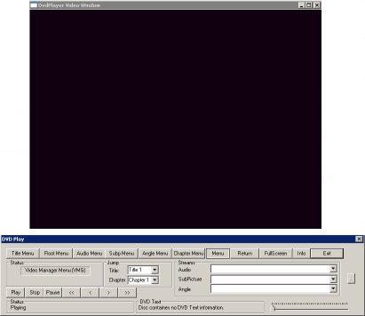

    Press the DVD Play button. Press OK to this message if you get it:
    The DVD will commence playing as if you were normally watching it. Use the Title and Chapter dropdown boxes to navigate through the DVD to identify the chapter(s) you require and the titles they are contained within.

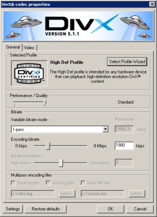

    Click the Configure button. If you do not know what you should be setting the values to, set variable bitrate mode to 1 pass and set the bitrate to 1000. This will give you a very high quality AVI ! I suggest you use the start and end method described later in this guide and encode a 1 minute long sample file to test the quality of your creation if you choose to use this, as you may need to up the bitrate if there is lots of motion.

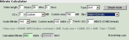

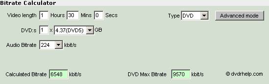

    If you wish to fill one CDR with an entire movie, use the bitrate calculator here to calculate what bitrate to use. When you first go into the bitrate calculator, the page looks like this:
    Click on the Advanced Mode button, change the Type to DivX, change the audio to whatever your audio's bitrate is, and enter the running time of your movie in the video length section. You should have the screen looking very similar to this:
    All you need is the Calculated bitrate, which in my example is 862 kbits. A good rule of thumb is to subtract 20 off this value to guarantee that it will fit on 1 CD, so I would use 842 kbits based on my example.
    Set the variable bitrate mode to 1 pass if you wish to encode CBR - this is easiest way. Set it to Multipass, 1st pass if you are doing the 1st pass of a VBR encoding. Set it to Multipass, nth pass if you are doing subsequent passes of a VBR encoding.

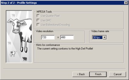

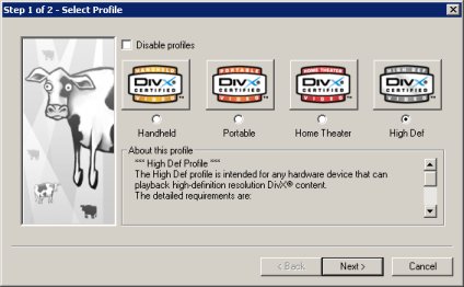

    Click the Select Profile Wizard button. Select High Def and click the Next button.
    Enter 720 X 480 as the video resolution for NTSC or 720 X 576 for PAL and select either 24fps or 30fps for NTSC or 25fps for PAL. Click the Finish button.
    Click the OK button. Click the OK button again.

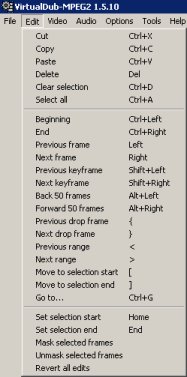

    Once you have your settings finalised, it is time to edit the movie itself. You can advance one frame forward by pressing the right arrow button, and one frame backwards by pressing the left arrow button. More presets are listed in the Edit menu.
    There are two ways to edit - set the start and end points of material you wish to save (disregard anything outside these points), or set the start and end points of sections that you wish to delete (similar to removing commercials on TV captures), leaving only the parts of the DVD that you wish to save. When you work out the start point, either press the Home button or go to Edit > Set selection start. Navigate to the end of the section that you wish to save/delete, and press End, or go to Edit > Set selection end.
    Press the Delete key if you wish to remove the selected section.
    Go to File > Save as AVI if you wish to save the selected section. You can elect to save the files at a later time by way of the Job Control function - simply tick the Don't run this job now; add it to job control so I can run it in batch mode tick box on the Save As screen. To access the batch list, go to File > Job Control and click the Start button to commence the queued jobs.
