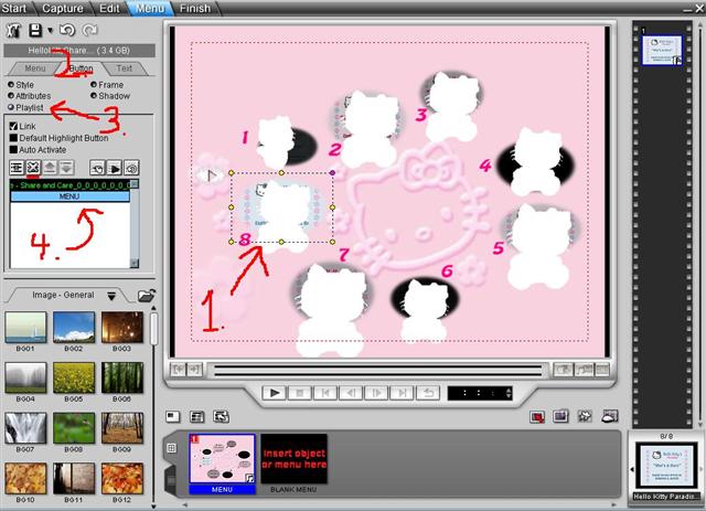

1. Click on your motion thumbnail to highlight it.
2. Click on the Button tab.
3. Select Playlist for your thumbnail.
4. Delete what you don't want it to link to (your short clip), and drag into the playlist what you do want it to link to (your main movie).
Hmm that doesn't work.
I do what you say, but when I take one of the movies away from the playlist it deletes it from the actual thumbnail as well.
Another words...
1.) I have a blank thumbnail
2.) I drag my 15 second clip into the thumbnail so the graphic appears within the thumbnail.
3.) I delete it from the playlist
4.) The graphic gets removed from the thumbnail...
5.) Doesn't matter at this point, but when I drag the actual movie file into the playlist it puts the graphic for that one in the thumbnail.

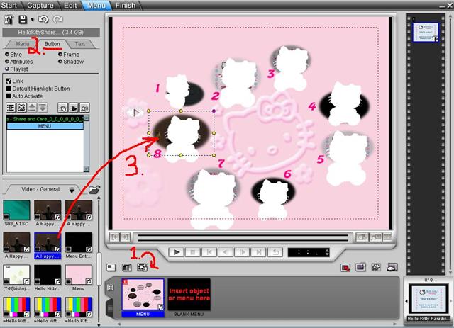

OK, I figured it out.
1. Use the Create Menu Wizard normally.
3. Drag your short clip from the Library onto your thumbnail.
That's it! No need to edit the playlist. It remains linked to your main movie.

Yep that did it!
So I guess the problem was I was adding those 15 second clips as actual titles instead of adding them from just the library manager. I didnt know it made a difference but I guess I know now
