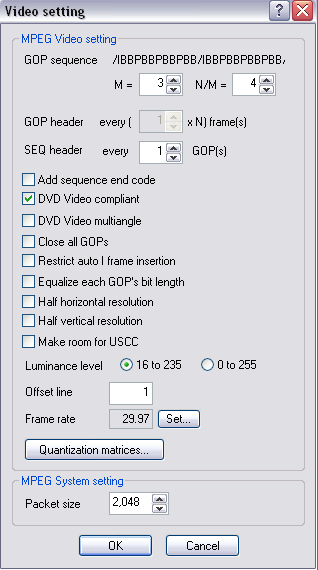

The final DVD looks like the jumpiness has been magnified. I was wondering if my script is taking into consideration bottom or top field first. I don't actually understand the script that is why I'm asking. I read hear in the forum a reply by a moderator or sombody else smart that said that some of this jumpiness could be caused by encoding with top field first instead of with bottom field first. Any suggestions would be helpful.

I'm now using CCE version 2.67 and I don't see anything about selecting the field order under the video tab:Originally Posted by adam
Is there something elese here to click that selects the correct field order?
Will this take the place of selecting the correct field order first in CCE if the current version of CCE that i'm using doesnt allow me to select which field order goes first?Originally Posted by vhelp

In version 2.67 of CCE you change the field order using the offset line option. Right now you have it set to crop the top scan line, which normally would be correct for DV footage. But I guess that script of yours reverses the field order giving you tff footage, so in CCE you should set the offset line option to 0.
Yes pulldown.exe does other things besides just add pulldown flags. Make sure and set the nopull option so that it won't add the pulldown flags, and then set the field order to the opposite of whatever it is now. You can see what your current field order is with BitrateViewer or DVD Patcher. You could also change the field order in DVD Patcher.Originally Posted by videocheez -
I reencoded and changed the offset to 0 and it looked ok on Media Player then I decided to run pulldown and select tff which changes the field order. I burned to DVD and the quality of the final movie is very good finally. I'm confused, by selecting tff in pulldown did I effectively reverse the field order of the CCE encode or is something else going on? Now I'm going to test by creating a DVD that has CCE with 0 offset line option and no pulldown. I'm trying to dial this process in right now on this movie because I got a lot of home movies to shoot this summer.Originally Posted by adam

Essentially, CCE always outputs tff video. So if your source is tff (your DV was bff but your script reversed it) then you set offset line to 0 to leave it alone. If your source was bff you'd select offset of 1 to crop the first scan line to make it tff.
Since your encoded output was tff, setting it to tff in pulldown didn't change anything. You just set the flags to the same way they already were.
