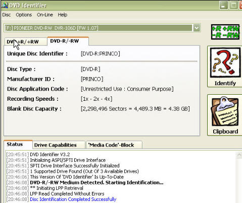

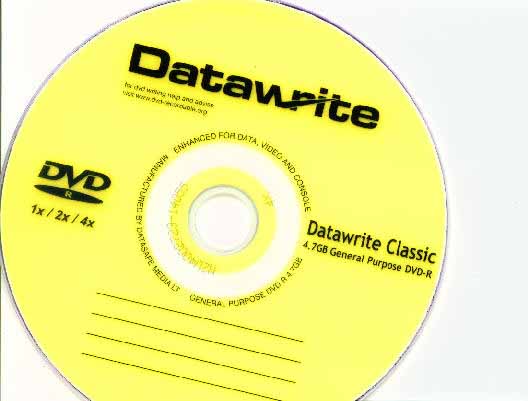

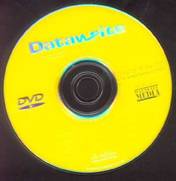

well i have been using datawrite yellow as they say the dye used on them is g04...i thought this was good or have i been misinformed?
Here is a Datawrite Yellow as you can see it's Princo.

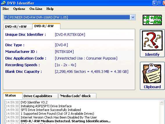

DVD Identifier is a nice little tool.
So whoever told you that was talking rubbish or lying.
The dye is quite a bit paler than RitekG04 , I like Datawrite Yellow though they work for me. -

This is the disc I ran through DVD Identifier.
It just goes to show you don't actually know what your getting until you get it home and test it.
