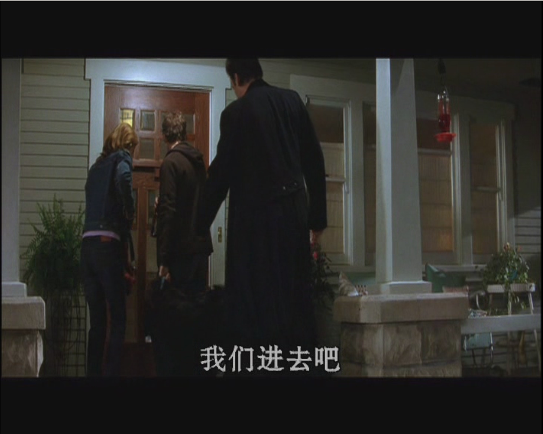

    picture 1 (which is the correct aspect ratio that I tally with the DVD, using with CCE)
    picture 2 (which is the wrong aspect ratio, save as to avi in virtual dub mod)
    Is there any setting I need to do on virtual dub mod in order to get the correct aspect ratio?
    I for one, agree that pic 2 is better quality but in wrong aspect ratio.

  5. Your CCE encode has the 16:9 flag set. You need to do the same with whatever codec you used in VirtualDub (Xvid, for example, supports aspect ratios). Be aware that not all players will respond to aspect ratio flags in AVI files. It's safer to resize the frame to the correct aspect ratio then use square pixel encoding. For example, resize the frame to 720x404 (about a 16:9 ratio). I would also crop away the black borders.
    LanczosResize(720,404)
    Crop(0,54,720,296)
    I would do that before VobSub().

  7. If you resize first it is easy: DVD only comes in two flavors: 16:9 and 4:3. Resize to one of those frame size ratios (740x404, 720x540, 640x480, etc.). Then crop away the borders. Leave at least a mod 4 frame size. Mod8 is better. Mod 16 best.
