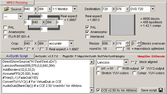

    I'm a lil stumped. I have a avi that is between 4:3 and 16:9 aspect ratio and I want to make a 16:9 PAL DVD.
    source: 640 x 384 (1.667) avi
    target: 16:9 PAL (720 x 576) DVD
    Could you please help me with the LanczosResize and AddBorders settings.
  4. Are you having trouble using FitCD for this:
    So, your script for an AVI might be something like:
    AVISource("C:\Path\To\Movie.avi",False)#False disables the audio
    Lanczos4Resize(656,576)
    AddBorders(32,0,32,0)
    #AssumeFPS(25.000)#use if speeding it up
    ConvertToYUY2()# For CCE, ConvertToRGB24() for TMPGEnc()
    And encode for 16:9.

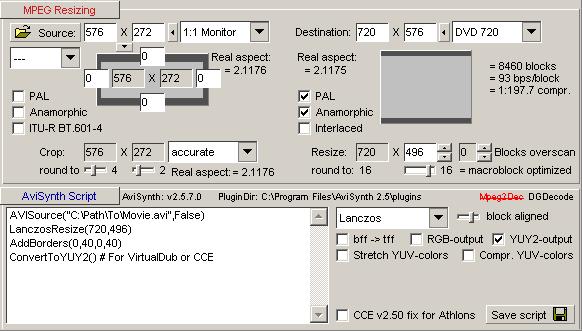

  5. Hello
    With the help of some distinguished member I have made a try to do my first advanced encoding.
    The original AVI video [DivX] video info is as follows:
    WxH= 576 x 272
    Aspect Ratio= 2.118
    PAL
    I am stuck at the AVISynth Script part. What should be the LanczosResize() line for a required Result of PAL, Widescreen DVD?
    I tried to figure it myself using the following two methods:
    1. I used AVI_RC2 resize calculator, and it gave the following result:
    Movie Aspect Ratio 2.12:1
    Movie Resolution: 720x496
    Format Resolution: 720x576
    As I was not sure which one to put in the AVI Synth script, I tried to use both, but none seem to result in a proper 16:9 appearence, the black bars in the top and bottom portion of my PC screen ware rather too narrow.

  6. The script you "ultimately" followed creates a non-compliant video. Why? Because the resolution it produces is 688x352. The complete script above it was compliant, but for a 4:3 encode with 2 blocks overscan (which is where your narrow pillarbars came from). I'll assume you want to create a 16:9 encode and no blocks overscan:
    I removed the numbers to the right of 720,496 as they are the cropping figures, but no cropping is being done.

  8. 1. No real reason. It was partly to show you how to use FitCD. You didn't seem to like all the black, so I chose the method that minimized it. A good case can be made that you should actually encode it as widescreen 4:3 but without the blocks overscan, like this:
    LanczosResize(720,368,0,1,576,270)
    AddBorders(0,104,0,104)
    2. The AddBorders command adds black in a clockwise manner, beginning with the left side:
    AddBorders(L,T,R,B)
    So it's adding 40 rows of pixels to both the top and bottom (and not the sides). In that earlier AddBorders you had:
    AddBorders(16,112,16,112)
    You were adding 16 columns of pixels to both the left and right sides, because of the default 2 blocks overscan, and 112 rows of pixels to both the top and bottom.

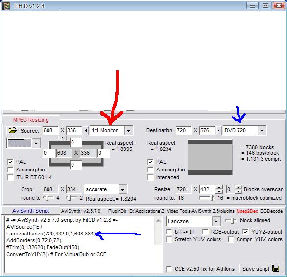

  14. I am a perfect newbie in the world of AVISynth. I wish to convert a XviD AVI video clip to MPEG2 [PAL DVD], 16:9 output. I intend to use CCE only for the video conversion. I have already converted the original audio to AC3. Could some one please check the following script, whether it is alright?
    # -= AviSynth v2.5.7.0 script by FitCD v1.2.8 =-
    AVISource("E:\Private.avi",audio=false)
    LanczosResize(720,432)
    AddBorders(0,72,0,72)
    #Trim(0,132620).FadeOut(150)
    The original avi info are as follows:
    608x336, real aspect 1.8234, PAL. The audio was in mp3, but as I said I have already demuxed the audio and saved separately as AC3.
    I tried to use AVI to DVD Resize calculator II, but that is showing that the Movie Resolution and Format Resolution both 720x576. So do I need to change the script line "LanczosResize(720,432)" to "LanczosResize(720,576)"? As I said, I would like to have my end result as widescreen format.
    So please help me out.

  15. So do I need to change the script line "LanczosResize(720,432)" to "LanczosResize(720,576)"? As I said, I would like to have my end result as widescreen format.
    Yeah, change it. Actually, FitCD gave me this:
    LanczosResize(720,576,0,1,608,334)
    which is almost the same.
    You screwed up your earlier script because you didn't set the Source as 1:1 Monitor.
  16. Thank you very much manono, you are a savior.
    Sorry sir, I disagree. I am attaching a thumbnail, please tell me where I really went wrong with FitCD.
    Thank you again.

  17. One more thing that I should inform you is that if I use this instead of the one in thumbnail:
    then when I check the script in the VirtualDub> File Information, then the output frame size is showed as 720x720.
    আমি বাংলায় গান গাই
  18. Ok I found the difference. You were using anamorphic, while I was not.
    But I guess I didn't last as your savior for long. OK sorry. I was trying to figure out how you got your script, and changing from 1:1 monitor was one way. And, as you discovered, unchecking Anamorphic was the other. BUT, since you had said originally:
    I assumed that you already knew to check the "Anamorphic" box.
    Remove the AddBorders line. Since you already have a 720x576 resized video, why would you then still need to AddBorders? It's good you checked in VDub, though
    Yep, since you said 16:9 originally, then why didn't you check that box?
