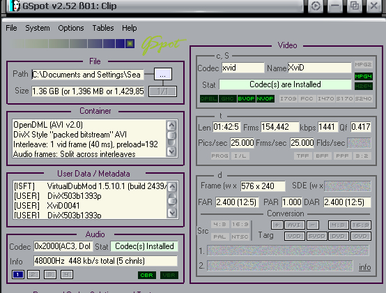

	ok ive spent all weekend  trying to convert  .avi - dvd using this guide.problem is the audio is way out of sync after i author no matter what method or type audio  i use, save wav,demux ac3,wave-ac3 in besweet, or re-encoded mpg audio.i only just realized my encoded video ends up 1:47:24 a full 5 min. longer  than the source 1:42:58.i assume audio is not my problem but rather video encoder settings. trying to convert  .avi - dvd using this guide.problem is the audio is way out of sync after i author no matter what method or type audio  i use, save wav,demux ac3,wave-ac3 in besweet, or re-encoded mpg audio.i only just realized my encoded video ends up 1:47:24 a full 5 min. longer  than the source 1:42:58.i assume audio is not my problem but rather video encoder settings.
 my source:
 [img]https://forum.videohelp.com/images/guides/p1571569/ http://i67.photobucket.com/albums/h287/vanboozin/b9ce9c0c.jpg
 (sorry i don't know how to directly insert pictures here)
 last script i used:
 clip=AVISource("Clip.avi", False)
 aud=WAVSource("audio.wav")
 AudioDub(clip,aud)
 ResampleAudio(48000)
 LanczosResize(720,360)
 AddBorders(0,60,0,60)
 AssumeFPS(23.976, True)
 i am using cinema craft SP2,any HELP or suggestions would be greatly appreciate. i am familiar with avisynth scrips,virtual dub, xvid codec,bit.calculators etc.i encode high quality xvids from dvd all the time but this is really driving me nuts![/img] or suggestions would be greatly appreciate. i am familiar with avisynth scrips,virtual dub, xvid codec,bit.calculators etc.i encode high quality xvids from dvd all the time but this is really driving me nuts![/img]
	Hi-
 A 25fps AVI but:
 What did you think would happen? You lengthened the video but not the audio. At least you said nothing about using the 25->23.976fps preset in BeSweet. Either lengthen the audio to NTSC length, or leave the framerate alone and use DGPulldown afterwards for 25->29.97.

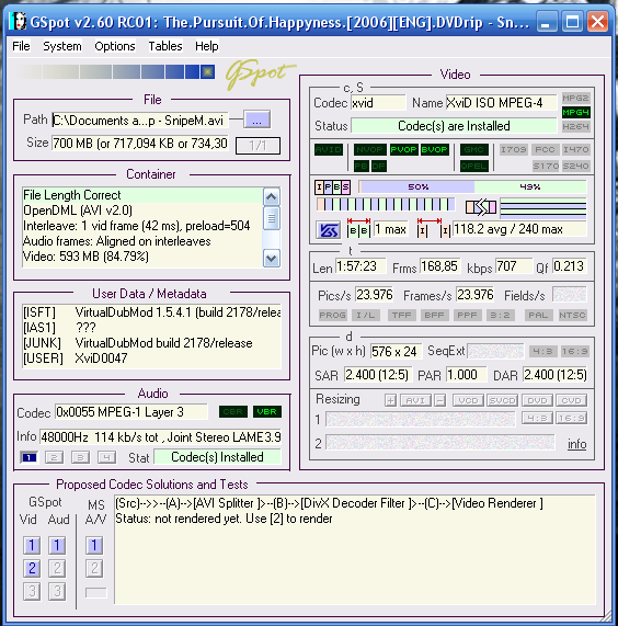

	Hey thanks alot. I accidently posted my message b4 it was done. Hopefully you can give me some support with this too. When I try to drag and drop the "movie.avs" into virtualdubMod it says that it cannot detect file type. Here's what I have in there:
 clip=AVISource("C:\happyness\movie.avi", False)
 aud=WAVSource("C:\happyness\audio.wav")
 AudioDub(clip,aud)
 ConvertToRGB24()
 I'm using TMPGEnc as the encoder. The aspect ratio I got was 2.4 so I just used the 2.35. I got an error when I uploaded the avi saying:
 I clicked no and then I saved the audio as a wav file. I have the avi, wav, and movie.avs files in one folder. What am I doing wrong?virtualdub has detected an improper VBR audio encoding in the source avi file(audio stream 1) blah blah.... Do you still want to rewrite the header?
