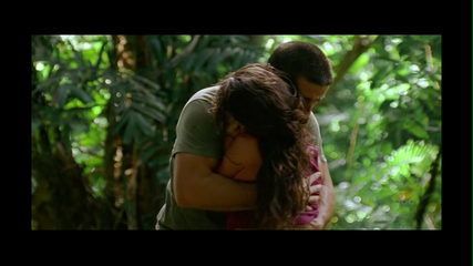

	i have a litlte problem....
 when i'm encoding an .avi file (eg an episode from LOST)and choose 16:9 aspect ratio(wide screen),
 this is what i get:
 Pls smn answer 'cause in a few days i have to have all the season 2 burned on dvds. [/img] [/img]
	Thx dude!
 1 more quetsions:
 which is the difference between the RGB color model na the YUY2 one?
 edit:Is FitCD the best Avisynth scripter out there?
 edit2: When I select this options in FitCD
 and these ones in CCE
 this is the result picture it's too wide screen it's too wide screen ) )
 what the hell I have to do? pls help... [/img] [/img]
