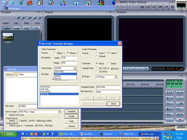

You should be able to use TMPGEnc to set the framerate of the MPEG you save.
Here is a screen capture for the editor I use - MPEG Video WIzard. Yours should be similar:
You can see the scroll window where framerate is selected
Try 24.
