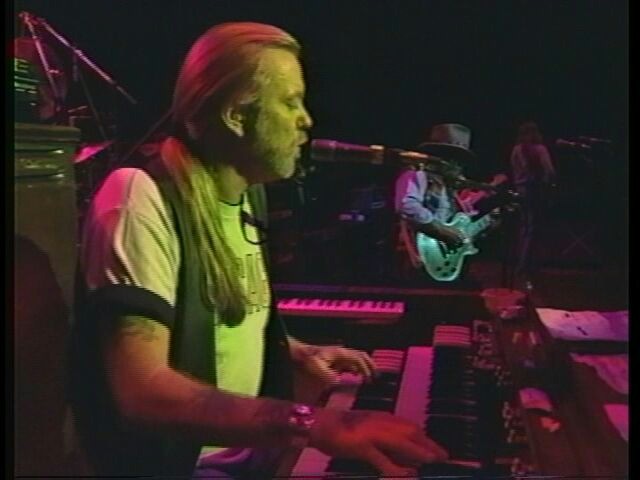

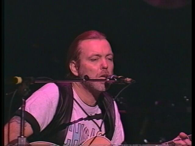

  20. Power DVD screen grabs from a VHS backup to DVD-RW of Allman Brothers Band Live at Great Woods recorded with the JVC DR-M10SL in FR mode set at 1 hour 35 minutes (resized to 640x480):
    I used the S-Video out of a JVC SR-W5U (W-VHS/S-VHS/VHS) VCR with on-board digital TBC, DNR, etc. and ran it through a Sima SCC Color Correcter Pro to enhance, sharpen and stabilize (code for defeat MV). The new JVC DVD recorder did the rest.
    There is some comb effect visible in these frames since it is interlaced, but watching this on a normal TV it looks fantastic. Virtually no video noise and a rock solid picture. Beats any VHS I've ever seen. Looks better than the original, to be honest.

  24. Originally Posted by Sam Ontario
    Resulting FR PQ is not particularly good compared with recording at 4-hour mode. With VHS tapes, 4 hour mode is more than adequate.
    That's probably true. I guess I'm just pretty excited because this is by far the best looking VHS cap I've done either by various computer methods I've tried, or with my other (Panasonic) standalone DVD Recorder.
    Is the comb effect a result of the Sima processor?

  27. Video Restorer lordsmurf's Avatar
    The "comb" is interlace. That's normal. That's fine.
    I wouldn't say better. I'd say "closer to source quality". You can use XP 1-hour on a VHS tape, and it'll look great... but what's the point?
