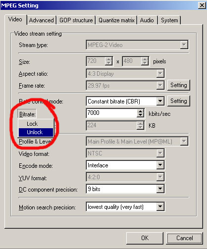

  12. ok mpeg1 it is. now what is an acceptable size for a 30 second clip? is ~1mb to small/too big? also what tools do i use to decrease the video quality/bitrate. tmpgenc only lets you do cbr. if someone would point me to an article on this it would be greatly appreciated.

    You can do VBR with TMPGEnc. If you hold your mouse pointer over where it says bitrate in the settings tab and right click on it you can select the unlock option and change it to whatever you want. Same for the rest of the 'locked' settings in there. Somebody prolly posted a jpeg of what I'm talking about somewhere around here but I'm too lazy and uninspired at the moment to go hunt it up.
    Ok maybe I'm not THAT lazy
    "There is nothing in the world more helpless and irresponsible and depraved than a man in the depths of an ether binge, and I knew we'd get into that rotten stuff pretty soon." -- Raoul Duke
  14. thank you thank you thank you sacajaweeda. i owe you a smoke and a pancake
