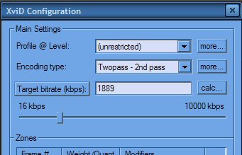

When you set up the first pass and save as avi, make sure you click "don't run this job now, add to job control...". There's really nothing special you have to do to set up the first pass other than having "two pass- first pass" selected. For the second pass, select "two pass- second pass" and make sure you're able to plug in a bitrate like this:
Plug in at least 1500kbps as I previously suggested just so you can see if you're happy with the quality. You might even want to only encode a short clip just so you can determine if that bitrate is acceptable to you. Make sure you add the second pass to job control as well. Lastly, go to File>Job Control and click "start". Post your thoughts on how good you perceive the quality to be. -
I already have the newest Xvid codec, and this is what i'm getting. I saved the first pass, and went to save the second and saw these.
So, I can choose a total size, but not a bitrate on the second pass? I think we may be using different versions of Virtuadubmod. I have 1.5.10. -
uninstall the older version of xvid before installing the new one.
josh -
https://www.videohelp.com/forum/viewtopic.php?t=223342
Do exactly what it says to do.If in doubt, Google it. -
Great site when using DVD Decryptor and Womble MPEG-VCR: http://www.dvdguideuk.dsl.pipex.com/dvdguide/editing1/editing1.htm
That seemed to do the trick man. That is the best quality I've seen so far, and probably the best I can expect from a comressed avi. So thanks again.
