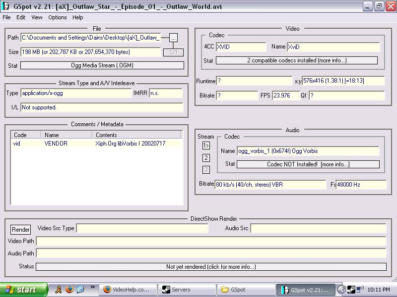

  25. I have been converting ogm to mpg quite easily with your guide dafreak, but recently I got a new computer, and I transfered most of the codecs and programs I had on the old comp. SO I tried to convert ogm to mpg again, and I get to tmpgenc, and it will open the .ogm file, but when I hit start to begin converting it, an error comes up that says
    "the error occurred when acm was initialized."
    I know that If I left the audio blank, it'd probably work fine, but I never had to do that before on my old computer, it would convert .ogm files from the same site to mpg easily with both video and audio, so Im trying to figure out what happened when I changed computers?
    all help is appreciated!

  27. hmm, the acm filter didnt work =( But now I know the audio codecs are whats wrong, do you have any more suggestions on other codecs I should go for? Or should i MAAAASS dl them all till it works?
  28. I would actually use gspot to determine which codecs are needed.
  29. so from that what do I need?
    p.s. can u see my pic? cuz I cant
