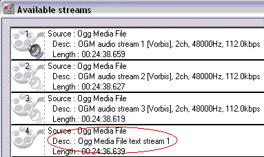

    Click on streams | stream list
    You should see several streams here.
    Click on the stream that contains text and then click on demux.

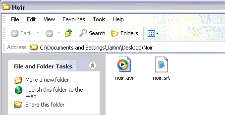

    You want to name the subtitle stream the same name as your avi file and in the same directory.
    So you should end up with something like the picture below:

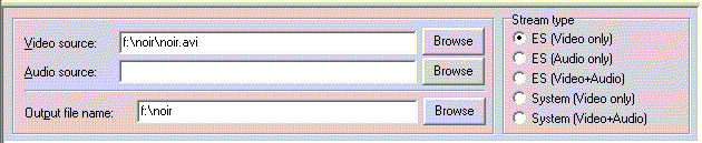

    Since we only processing the video portion with tmpgenc, we want to select ES (video only) located on the lower right hand corner.
    We want to eliminate everything that is displayed in the audio path so that the audio path is blank.
    It should look something like this:

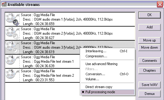

    Open the avi file in virtualdubmod again.
    Right-click on the audio stream that you would want and click on full processing.

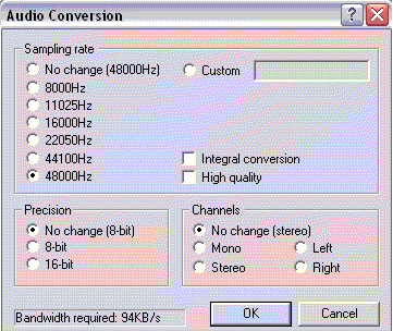

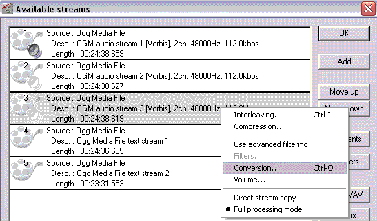

    Make sure the stream is 48000hz.
    If it isn’t 48000Hz, right-click on the stream again and select conversion.
    Place a dot next to 48000Hz and click ok.
    You can also place a dot next to 16 bit and place a check next to high quality as well but this is optional.
    Click on Save WAV.

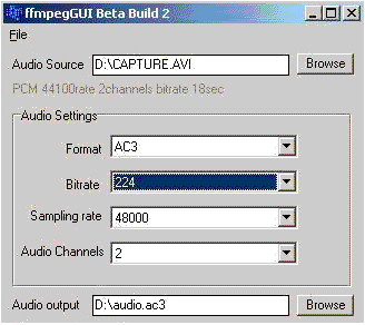

    Open the wave file into ffmpeggui. All the settings should look the same as the picture below. Bitrate can be changed, but I would not recommend using audio with a bitrate lower than 192 kb/s.
    When the conversion is finished you should now have both a video file (m2v) and an audio file (ac3).

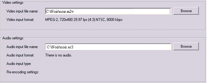

    Now that you have your two files, we need to merge them or multiplex them together and convert them to vob files. You can use tmpgenc dvd author to add menus, chapters and merge your files together to create vob files which you can then burn onto a DVD-/+RW.
    Open up tmpgenc dvd author and select new project.
    Click on add file. Choose the m2v file that we created earlier and then select where your ac3 file is for the audio path.
    It should looks something like the picture below:

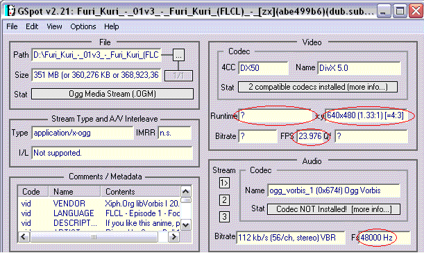

    Using Gspot and Bitrate Calculator to Determine Tmpgenc Settings
    Gspot is a handy tool to find information about your avi/ogm file.
    It will give you information about what codecs are needed to play media files as well other valuable information such as: frames per second, length of video, sample rate of audio, bitrate of the video and audio, aspect ratios, etc. All this information is useful for determining tmpgenc settings.
    This is what you should see when you load an ogm file into Gspot. All the information circled in red are important and you should take note of them. Unfortunately, Gspot is unable to determine the runtime of ogm files but this is easily remedied by playing the file/s in your favorite media player and noting the runtimes.
    When used in conjunction with a bitrate calculator it can help you determine the bitrates for 2-pass vbr and/or single pass cbr.

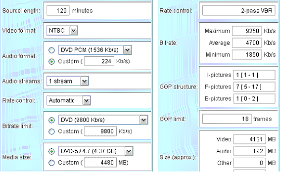

    Here is an example of this in action: Say I have an ogm file. I’ve determined that the file is 120 minutes long by playing the file in windows media player (NOTE: if you have multiple avi's you want to add to one dvd-r, add the runtimes together and enter the total minutes into the bitrate calculator). I’ve run the file through Gspot and have obtained the following information about the file.
    Runtime: 120 minutes
    Frames per second (fps): 23.97
    Aspect Ratio: 640 x 480 (1.33)
    Let’s determine the bitrate I should use. We will use the bitrate calculator found here: http://dvd-hq.info/Calculator.html?PHPSESSID=62c50d7df865dc4b8054b7c60293b03a
    I have entered the appropriate numbers into the calculator.
    I set Audio Format to Custom because I will be using ac3 audio. Generally I will set the audio bitrate anywhere from 192-256 kb/s.
    Here’s a picture of what it should look like:
    From the information gathered we can enter the following settings into tmpgenc:

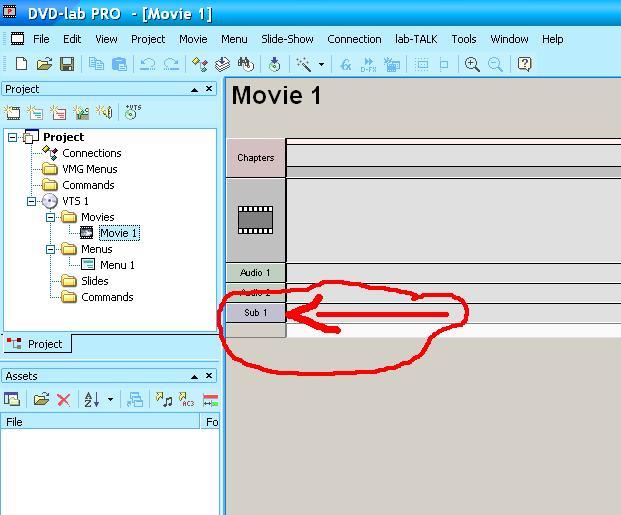

    you can't use tmpgenc dvd author then ,you must get an authoring tool with several audio tracks support like dvdauthorgui.
  4. dvd-lab pro also has the ability to multiplex several audio streams and subtitle streams.

  18. where did u download ur bitrate caculator
  19. i didn't download it, i just go to the website and punch in the numbers.
    bitrate calculator can be found here
  20. thanks a million
  21. rikstron, don't forget to change the audio streams to 2 streams, on the bitrate calculator, since you will be working with two audio streams.

    Hey I'm new to all this but how do i preview the menu? I'm using DVD-Lad PRO. I tried with PowerDVD but I diddn't know how to get into the menu.
    Also, DVD-Lad PRO won't load the sub file. I try import the srt file but it won't import.
  23. to preview your menus, there is a small red play button. once you click on that, a console opens up with arrows. use the arrows to navigate through the menus.
    I dont't think you need to import it.
    add all your audio, video and subtitle streams to the audio/video tab.
    once you have them there, you can just drag and drop it onto the movie, or highlight the subtitle stream and choose insert.

    If you are using DVD-Lab Pro. To load your subtitle stream ( .srt ).
    Click on the MOVIE 1 tab. Then where it says : Audio 1 and Audio 2, their should be a purple bar saying Sub 1. Click on that and then import your .srt file.
    Have fun!!! ^_^
    Here is a picture to help you out: https://www.videohelp.com/forum/images/guides/p968203/DVD-Lab%20Pro.JPG

    I have some problems with an OGM file I just downloaded. It has one subtitle stream and one audio stream. I want to put it on DVD and make the subtitles selectable. I managed to get that part done. Also, are you sure it's safe to rename the OGM to AVI? Will anything get corrupted?
    As for the video, the specs are pretty weird. 512x384. What should I set the size in TMPGEnc? Resizing to DVD standard would lose quality right? Also, the FPS is 24.000 which makes me have to do even more.
    You said in the guide above to take the Ogg Vorbis audio stream and save it as a WAV in VdubMOD. However, you said that you don't recommend using audio below 192 kbps. Well, my audio stream is 107.0 kbps. Can I still convert it to AC3?
  26. If you're afraid to rename the file to avi, then make a copy of the ogm file and rename the copy.
    for the size of the video, you can do a few things. the aspect ratio for it is 1.33. set your output ar to 4:3, and your source to 1:1 ar. you can either keep it the original size, by using center (keep aspect ratio) or center (custom size), you'll most likely see a frame around the video during playback, or you can set the size to full screen by using center (custom size) and setting the size to 640 x 440. you can use fitcd to customize to find a size.
    you can also use 1/2 d1 but you will have to do some research on that because I'm not too familiar with it.
    to answer your third question, yes, you should not have any problems converting your audio to 192+kb/s ac3.

    Thanks. At first it won't work when I renamed it to AVI. So I used VdubMOD and set the video at Direct Stream Copy. Then I saved it as an AVI. It now opens fine in TMPGEnc. :P
    Now about the 24.000 framerate, what can I do about it to get a smooth result? I don't want rickety panning scenes.
    Also, why did you say it had to be 640x440 for the video arrange method? In the past when I had to work with hardcoded subtitles, I would set it at center (custom size) 640x420 to keep the subs from going off the TV screen. Should I use 420 or 440? The subs are pretty low so I'm afraid it would go below it if I used 440. But then again after hearing you say that about the 440, I'm wondering if I might have squished the video a bit by using 420. The subs are fine at 420 though.
  28. yeah, it's fine as long as the subs don't get cut off. I've used 640 x 440 and it worked fine.
    24 fps is really close to 23.97 so set it to 23.97 and use 3:2 pulldown and it should come out fine.
