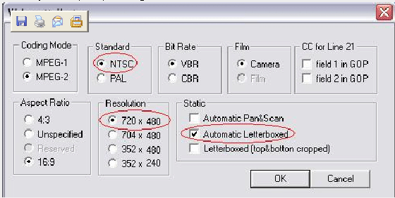

    This Patch Method worked fine for me in three convertions, but I still have a big doubt...
    When this window opens
    Sometimes the "Aspect Ratio" is in 4:3 and sometimes in 16:9, does this matters? Do I always have to choose one or should I leave this as it appears?
    And sometimes the "Static" part has the Automatic Pan&Scan option selected, does this matters? Do I have to leave it as it is or do I have to always un-select this option?
    Thanks in advance...
    PEACE.
    PEACE
  15. Member DJRumpy's Avatar
    Dallas, Texas
    The aspect ratio should remain unchanged, as you haven't actually changed anything in the MPEG itself. Changing the aspect can cause the video playback to appear to tall or wide, depending on your player, and your display. The Static setting SHOULD be changed. In order for this cheat to display properly, your player will need to scale your dvd, and to do this, you should select the Automatic Letterboxed setting.
    Essentially only those items circled in red should be modified. Leave the others untouched.
    Impossible to see the future is. The Dark Side clouds everything...

  24. Great guide DJRumpy but you might add:"if the video is 4:3 you select automatic Pan & Scan",so it will play properly on a 16:9 tv.
