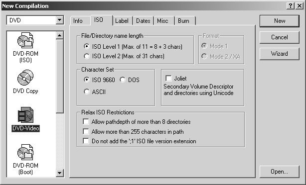

    I think Nero is telling you what your problem is, you just aren't listening to it. You said the error you got from Nero was
    "you have added DVD-video content to a compilation type that will not result in a DVD-video compliant disc....."
    That tells me you did not select DVD-Video as the type of compilation you want Nero to create for you. Nero is smart enough to tell you what it thinks you want to do (i.e. it recognised that you had DVD Video files), but you have to make the final call yourself.

  9. Member Roderz's Avatar
    Jul 2003
    the armpit ofthe Midlands
    I use the Nero on the mode of UDF/ISO
    will give you
    SELECT the DVD-Video option and leave as in pic,
    as for my version I use 5.5.10.42, as early V6 had some/lots of issues,

    Any chance you could post a screen grab of the setting u r using in nero?
    R U setting it up as pic above?
