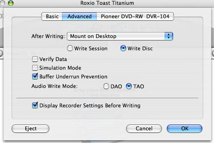

At the bottom of the Toast open window, it should list your drive.
What does it say? under the Recorder tab, where it says Recorder settings,
what does it list your drive at, and what selections do you have checked
under the advanced tab? They should look like this:
I'd be ecstatic if it wasn't the burner, and if you can help me determine that, huzzah.
At the bottom of the Toast window, it list the burner as the Panasonic DVD-RW DVR-104.
The recorder settings are:
WHOA!
Are sure Panasonic..?!?!?!?
Your Toast Recorder settings list a Pioneer DVR-104?!?!?
the Recorder settings window is correct.
Switch to DAO ( Disc at once, which is the mode iTunes uses,
rather than TAO which is track at once, and which can cause Underrun)
and test and let us know. -
