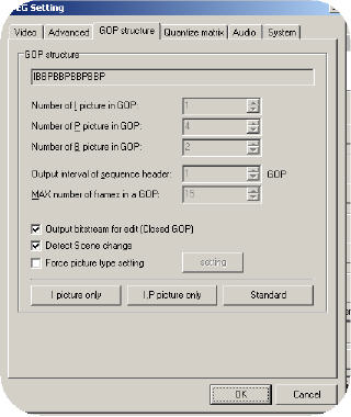

    I had this error the other day and ran it through TMPGEnc and in "settings' I changed the GOP to 15 (PAL) and it worked. TDA will actually tell you what the GOP should be.

    change GOP here, press settings
    then go here
