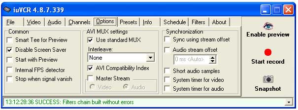

    As for using iuVCR ...
    I'm using a new technique I discovered on the forums at the doom9 website
    My capture was in perfect sync but I only captured the first 20 some odd minutes of the movie so I'll have to see what happens with longer captures.
    Basically I set up iuVCR like this:
    Then after the capture I used this program I found which "fixes" the stream offset (in this case it was -67ms).
    That program is called AVI Offset Calculator and can be found here:
    http://darkfalz.kiczek.com/software/
    I read about that program here:
    http://forum.doom9.org/showthread.php?s=&threadid=73901
    I set up iuVCR the way I did per the suggestion of the person that wrote AVI Offset Calculator.
    Anyways this method still needs to be tested more ... I have a funny feeling that it might not work for longer captures. Also if you have any frame drops (which I did not in my one test capture) I would imagine that this method might not be so great. However with most VHS sources I tend to get very little frame droppage (usually no more than maybe 4 to 8 frames through an entire movie) so maybe that's not enough to screw things up?
    Anyways right now I'm doing a VERY long encode of a PAL to NTSC project so I won't be able to test any capture stuff til probably sometime early next week. This encode was started last night and won't finish til Sunday ... damn slow ass computer I have hehehe
    - John "FulciLives" Coleman
  10. Member DJRumpy's Avatar
    Dallas, Texas
    I'll stick with VirtualDub.
    One program. No sync loss. Err..make that two programs. I use a scheduler program called 'VirutalDub Start Timer', which starts and stops the record, but I've been using it for two years without a single loss of sync. No editing or stretching required after the fact.
    Fulci, I see an option there to 'Sync Using Stream Offset'. Wouldn't that be the equivelent of the VDub setting to sync audio to video? It might eliminiate any sync problems.
    Impossible to see the future is. The Dark Side clouds everything...
  11. Member FulciLives's Avatar
    May 2003
    Pittsburgh, PA in the USA
    Well I have been using TheFlyDS to capture for a while now and it has been working well for me in maintaining audio sync but just recently I captured something that was about 2 hours long and I only had 6 dropped frames in that whole period of time (2 at a time spread out) and it was ever-so-slightly out-of-sync. Don't know why ... doubt it was the dropped frames.
    Anyways with TheFlyDS I was using MASTER STREAM = AUDIO but that gives you an "odd" frame rate in the end ... usually something like 29.967 or 29.966 in my experiences.
    Everyone seems to RAVE about iuVCR so I thought I'd give it a try again.
    I've tried the audio resample trick in VirtualVCR and that didn't work for me. I also tried the audio resample trick with VirtualDubSync (I think that's the name of that mod) and again it doesn't work plus I take too much of a performance hit using Vdub anyways because of the VFW/WDM wrapper thing ... forces me to capture at 352x480 or I drop frames whereas with TheFlyDS/iuVCR/VirtualVCR I can do Full D1 resolution captures.
    Anyways I'll be playing around some more with iuVCR ...
