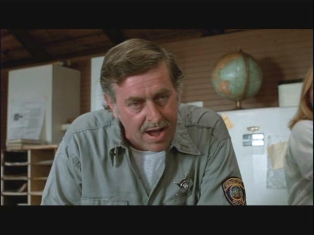

When I play back the MPG,(using POWER DVD), green blocks and other defects will occasionally pop up. If I rewind and play back the scene again, the green blocks may or may not be there.

This scene had green blocks and white blocks on the sheriffs face. But I played it back again it was fine ???

I had this same problem a while back. I even tried uninstalling and reinstalling but to no avail. I'm certain that it had something to do with other mpeg-2 decoders I had causing some kind of conflict. I ended up reformatting my drive and reinstalled the OS and I haven't had the problem since. Not much of a solution, but that's my sob story.
