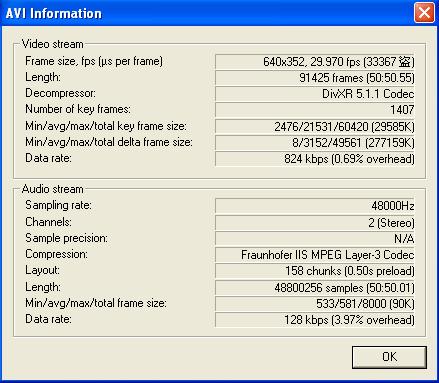

here's the file I want to convert, it's in .avi format

It's usually a good idea to dcompress to wav. Wav audio is much easier to transcode than mp3. You could probably get away with letting Mainconcept convert to mp2. There's nothing wrong with converting to ac3 though.Originally Posted by barqy
I think the default bitrate is 6000kbps for the DVD template, at least for CBR type. If you are doing VBR then yes, plug in the values you got from the calc.Originally Posted by barqy -
Well Bargy, if you have a DVD Burner, then this is what your Mpeg should be like.... it should have be of this resolution 352*480/576 352*240/288 720*480/576, or 704*480/576. your Audio has to be at 48000 Khz not 44100. then when you have an mpeg file in 2 gigs or whatever you will have to Author it, so that it can make all the necessary dvd files. now when that process is done open Nero, and select DVD Video, and you will have two folders AUDIO_TS and VIDEO_TS, the video ts which is red. well now open up the VIDEO_TS folder and drag all your authored files and click burn. or you know another thing you can do is get the newest version of DVD2SVCD, and you can go from an Avi to an Authored DVD, so when that is done all you will have to do is burn the VIDEO_TS AND AUDIO_TS FOLDERS.
