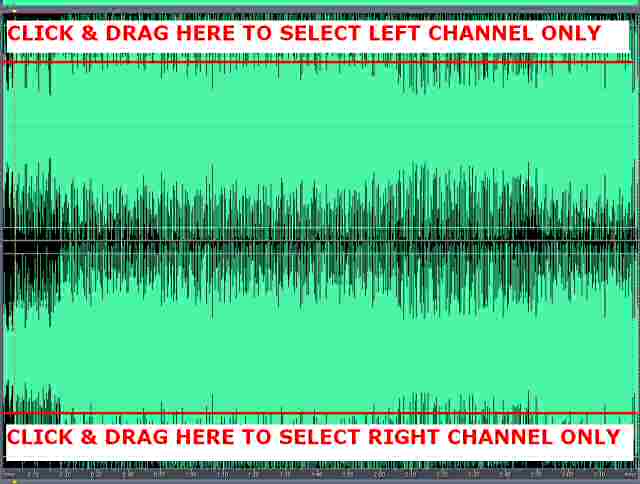

  8. I didn't have time in my last post because I had to get to a lecture, but I thought it would help if I illustrated what I'm saying since it isn't entirely clear. Open your audio file up in Cool Edit and you'll be presented with something like this, just with one track silent. This has two tracks - just pretend it doesn't:
    I've highlighted the areas you must click and drag to select one channel only.

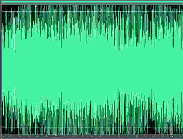

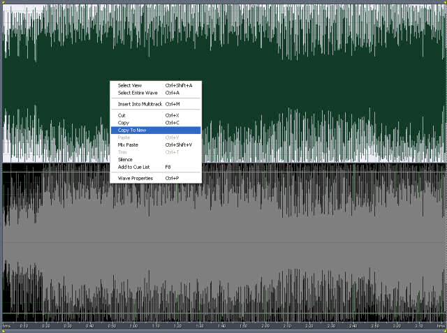

    Now, you must make a new file using only this one channel. This is much better than copy-pasting the good channel into the bad one to give a two-channel but mono file - creating a true mono file saves space. You will have selected the good channel, now right click it and select "Copy to new":
    You'll be presented with this waveform, which as you can see is mono:

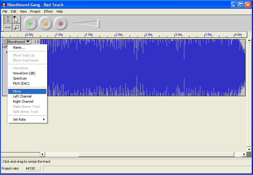

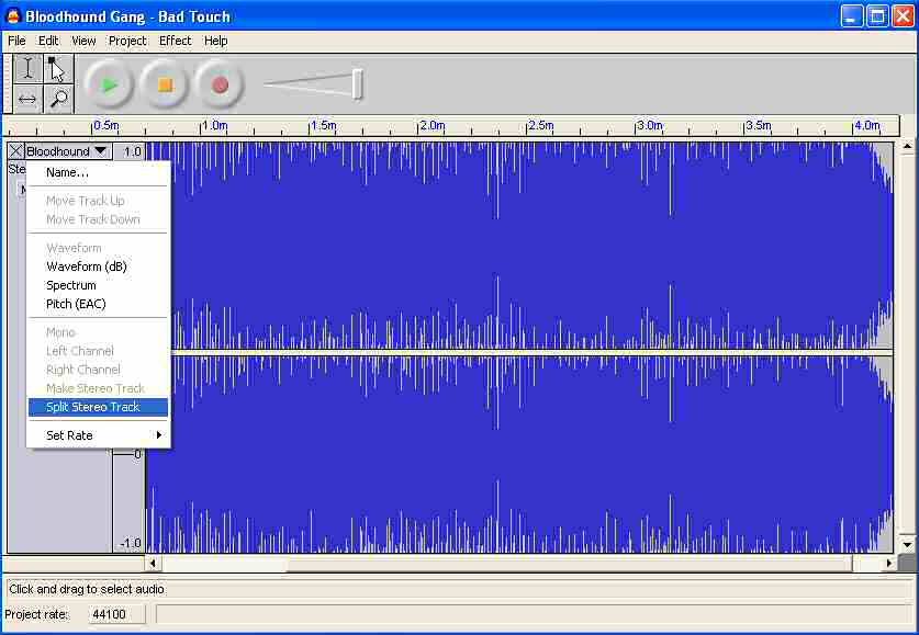

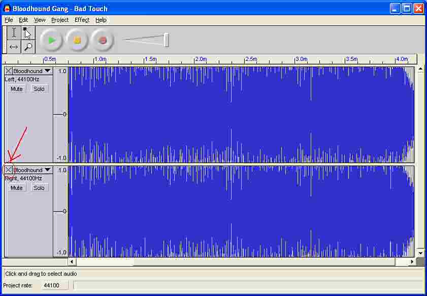

  12. Nice one teegee! After much buggeration, I managed to suss the problems Audacity was giving me. Here's how to get this done for free:
    Open the file with Audacity. You'll get the waveform appearing. Click the name/button shown and select "Split Stereo Track":
    Now, you need to delete the other, silent track. You just click the button shown here (or the other one, depends which of your tracks is silent):
    Lastly, and importantly, you have to tell Audacity that you really do want this as a mono track or else it will just save it as stereo with one track silent and you'd be back where you started. All you do is select "Mono":
    Just save in your desired format, and that will output a mono file that should work.
