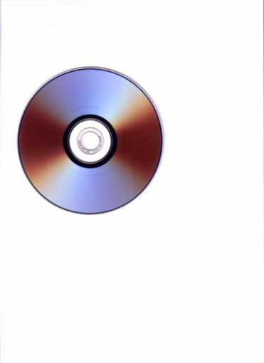

Yes that picture is the same thing I am seeing too.

the ring that stiltman uploaded is fine, that's normal on many disks. Fulci, yes, it seems that our issues are slightly different. Interestinlgy, I have had the same issue with a few riteks that you are having with Prodiscs. My problem is definitely different, and definitely is causing the issues. I'll upload a picture when I hookup my scanner later.

You just wanted a pict
as stated in my post 1.06. This is the one that came with my 1300a. I have not flashed it.Is anyone with a NEC ND-1300A getting good quality burns from ProdiscS03 and if so what firmware are you using and which ProdiscS03 do you have.
And yes that is the ring that I see on all my BLANK UNBURNED discs. after the burn I cannot even see it. I will take a closer look this evening.
I have not seen these rings on any Ricoh, CMC or MCC blanks. As mentioned just those orange silk-screened 4x DVD-R Riteks. -

these prodiscs are worth pissin on and that's about it. I've burned a ton of disks and never had any problems like i've had with these. Here's that pic of the burn rubberband type circle on just about every single one of the prodiscs I've burned. Not a scanner expert but if you zoom in you can clearly see the burn ring and it is much deeper looking at it in person. The speed drops enormously between 8-10% at that area which is exactly where the burn ring is and in most cases it errors out so the disks are nothing more then crap. Figures it would happen to me. I should of gone with supermediastores prodiscs as i'm pretty confident rima is aware of what they sent. One set of serial numbers burns much better and a much lighter ring then the other set of serial numbers as I posted before. I haven't called rima yet, didn't get a chance, but they'll never get another penny of my money regardless of how they remedy it.

DVDeeZ, that's just plain odd. That's not a lead-in ring. Something odd is happening on that batch or your burner.
