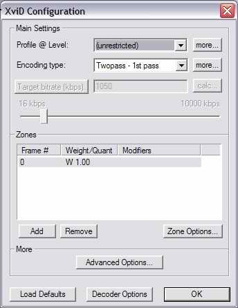

I would use Virtualdub. Install the latest xvid codec too. You can find the xvid settings in Vdub by going to Video>Compression>XVID MPEG-4 Codec>Configure. It will look like this:
