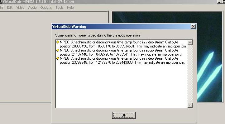

    I collect old anime videos and I have a very rare episode that was captured a while ago and it has droped frames left right side ways. I have to use mplayer2 to open it because the regular WMA goes very slow trying to play it.
    The Audio on it is acceptable, like you can understand whats goin on but video is pretty bad. Squares show up everywhere. I found someone who has the episode in a different language the video streams are identical just one is GOOD quality and mine is bad.
    I need to rip the audio out of mine and merge it onto the other.
    Here are my two problems
    A) I can't open the corrupted mpeg by Virtual Dub or TMPGEnc Both give me Error and I tried De-muxing it to get the mp2 audio and it only does the first 30 seconds and closes
    B) Syncing the two streams (So when the guy opens his mouth he actually talks not before or after by a second)
    note: The corrupted version is Mpeg format and the one that is in a different language is a DIV3 - "DivX 3 Low-Motion" and for Audio Codec "0x0055(MP3) ID'd as MPEG-1 Layer 3" According to Gspot V2.21
    Thanks in advance.

  4. I would -
    Open the AVI in VirtualDub, set Audio = no audio, Video = Direct Stream Copy, then Save AVI. This will create an AVI with video only. Direct Stream Copy will retain the file structure and make no changes.
    Open the MPEG version with your good audio in VirtualDubMPEG2 or VirtualDubMod (whichever will open it correctly) and save out the audio. In VDMPEG2 it's a simple "Save WAV" but if it won't do it then click Audio - Full Processing mode, Audio Compression - PCM (No Compression) then File - Save Wav. In VDMOD it's Streams - Stream List - Save Wav.
    Use AVIMuxGUI to mux those two together. Drag (from Explorer) in your new video and you new audio, click the video then click ADD then output a new muxed version of you film. Probably out of sycn as you said.
    Load your new file in VirtualDub and click PLAY and check audio sync. By what you said the audio needs delayed so click Audio - Interleaving - then add a number in the box labeled "Delay Audio By" and add a number like 1000. That means 1 second. Close the box and click play again. Add 1000 each time to that number until you get close to sync then add 500 (1/2 second), then 100, then 50, then 10, etc, until it syncs. Slide ahead in the file and check it there, then slide to the end and check. Finding that one number that syncs will take a little time but it is possible. What that number will be.... (?)
    Then click Video - Direct Stream Copy, File - Save AVI and save out a corrected file.
