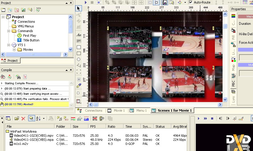

i got dvdlab pro trial version and tried it out using this guide but when i get to the render menu motion part i get the error "unnamed file was not found". i'm using a 10min dvd-pal mpg video. did i miss something.
however, if i skip this part and proceed to compile the dvd i get the error "Pre verification fails. Process abort!". need help, badly.
What are the exact steps you followed in order to render motion menu? From your screenshot it looks like you set chapter points, then had DLP automatically create the scene selection menu with the chapter points-picture in the boxes(except you changed the background). Then what did you do from there?Originally Posted by ermercado
