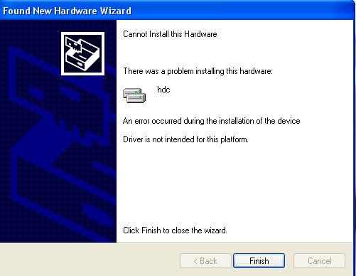

  4. i did this (uninstalled the primary ide channel and rebooted) but when i restarted, i got an error in windows when it was attempting to reinstall the primary channel driver
    The error i get is that ' hdc error driver is not intended for this platform"
    What I did was this, my Western Digital HD comes with a 'ultra ata/100 management' disk and I ran that as well and I guess I 'enabled' DMA.
    I tried to 'disable' it again (thru using the disk), but still I get this "hdc error driver is not intended for this platform" error
    i switched back everything i changed and i still get this error~!
    Anyone know how to fix?
    There's a big yellow ! when I go into device manager and look at my primary IDE controller (actually that isnt even there anymore, just says 'unknown device')

    It only came w/ the HD, no controlelr card.
    I went to the mobo website, d/led the IDE drivers for my mobo and restarted, then the thing wouldnt even boot up lol
    Went back to 'last known configurations' and problem is still there.
    everytime my comp restarts it says it has found new hardware, the HDC thing (what is this?), the primary controller, and the harddrive
    I get the error on the HDC installation

  8. Hey all,
    I just experienced the same issue last night. Nero was buffering like mad so I finally got fed up and looked on forum threads and noticed a few suggesting to look at the DMA settings. Sure enough one of the controllers (secondary) was set to PIO. How it got to that or what that even is I don't know. My primary was set to Ultra DMA and that was fine. So I tried to enable DMA on the secondary and it changed it but the current transfer rate still stated PIO. So I tried to reboot, still no go. I then noticed another thread that stated I should try to remove the controller and upon reinstall it will recofigure/reinstall. Well it did, but then I ran into the same cannot install this hardware HDC. Thinking there may be a conflict with the primary I uninstalled that as well. Only to have the same problem occur. Short of the old fdisk reformat and reinstall, does anyone have any suggestions? This is entirely frustrating...
    Thanks in advance.
  9. I had a similar sounding problem relating to this 'hdc' device. The key solution for me seemed to be installing the Via IDE Miniport driver.
