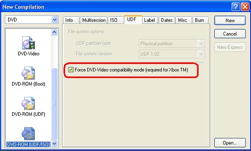

  8. In Nero you need to check the box 'force xbox compatibility mode'.
  9. Handyguy does Nero 6.0 have the "force xbox compatibilty mode" box and if it does where can I find it. If anyone wants to download nero 6 or 5.0 along with other programs go to - its a great site check it out.
