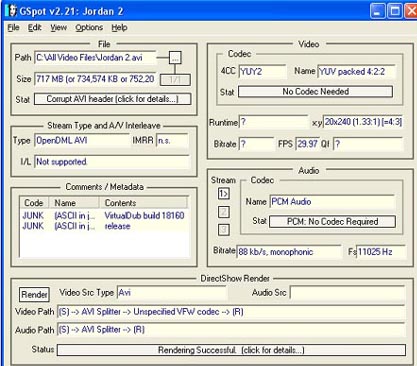

According to GSpot the source is an avi file, but the size shown in GSpot is only 717MB. But the size in my "master video file" in Windows XP is 4.70 GB. Is there a reason for this difference?
This is the info from the rendering:
I don't understand all of it but it's obvious that it is an avi file. That's one thing that I'm trying to get a handle on. Does the source always start as an avi file. For example, whether I'm capturing from a VCR, VHS Camcorder, or Digital Camcorder (mini dv) is it always going to start with an avi file or do the different types of sources each produce a different file type. Lots to learn.

I don't have any experience with mini dv so I will leave that to others but with most "capture cards" you can specify what format you want the output (captured file) to be. Depending upon what you select (in my case mpg2 program stream) some encoding may have to take place. Some cards do the encoding in hardware on the card, some with software in your machine. Reading some of the posts in the Capturing Forum may help, or not. AVI is an uncompressed format that will have larger file sizes but does have a lot of flexibility in editing. Of course, any format can later be converted to another. DVD requires mpg2 format, VCD is a mpg1 format, etc. Both of those are compressed formats and utimately your AVI file would have to be converted either by one of the tools on this site, or perhaps during the final authoring process.Does the source always start as an avi file. For example, whether I'm capturing from a VCR, VHS Camcorder, or Digital Camcorder (mini dv) is it always going to start with an avi file or do the different types of sources each produce a different file type. Lots to learn.
It can be a complicated process (and potentially expensive), and like anything else done well will require a lot of reading, playing around, etc. I would suggest getting to know your capture card and it's options as a starting point; along with the above-mentioned forums, guides, etc.
