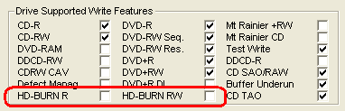

  22. If it turns out that your drive is an Optorite-Sanyo (if it can HD burn then it is) inside then you might wanna know that earlier firmwares had problems writing some DVD-R medias.
    https://www.videohelp.com/forum/viewtopic.php?t=187157&start=0&postdays=0&postorder=asc&highlight=
    If you experience something like that visit http://forum.rpc1.org/index.php for advice to flash the latest 2.60 fw

  26. If it can HDburn its an Optorite-Sanyo
    Check it with DVDInfo PRO
    Also read that Optorite thread I linked earlier
