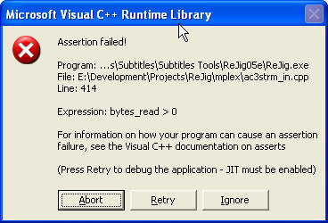

2.Trying to multiplex a demux NTSC movie with rejig I encounter this runtime error :
Any suggestion is highly appreciated. -
