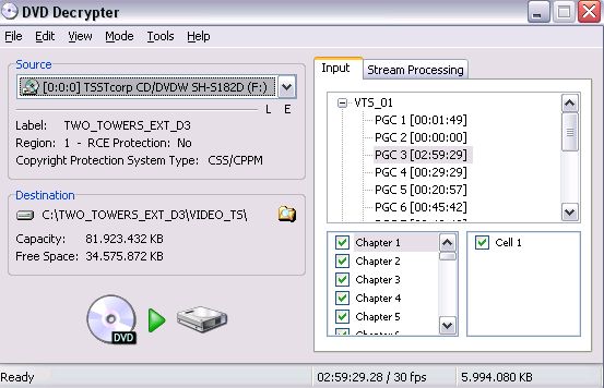

I'm trying to add subtitles in a DVD with Bonus Material (Lord Of The Rings: The Two Towers - Platinum Series Special Extended Edition DVD).
I'm in trouble with this step of your guide:
"In this moment the software will automatically choose the main film in order to demux it." (DVD Decrypter)
This DVD has many others parts (in VTS_01 and others) to be worked.
Is there anything I can do to get a disc with the same structure of original DVD, only with all replaced subtitles?
Thaks for your attention and sorry about my english.

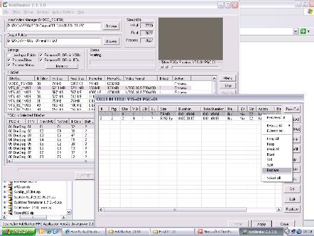

I don't know what the guide says. Open the DVD in DVDDecrypter set up for (the default) File Mode (and not IFO Mode, as shown in your pic), and decrypt the whole DVD to the hard drive. Then demux the movie alone from the other files using PGCDemux. Remux with Muxman (or however else the guide says to do it), replacing with, or adding in, your new subs. Then put the new DVD with your custom subtitles into the old original DVD using the "Replace" button of VobBlanker. That way you'll keep the menus and any extras on the original DVD, but also have the movie with the new custom subs.Originally Posted by fgt25
Hi, manono.
Thanks for your help.
I did make a test with VobBlanker and realize that will be able to make what I want. I put a translated subtitle in a litle PGC segment.
But the colour of this subtitle was changed.
I used the DVD Lab-Pro to rebuild the vob file. After this process the subtitle was white.
Then I used the VobBlanker to replace the specific cell of the PGC segment.
After that, I played the resulted movie. The subtitles was replaced but with brown colour.
You can say what I did wrong?

Hi-
You didn't do anything wrong.
If you're looking at the same pic of yours that I am, then you already know it's pretty useless, as you can't make out anything. But if I'm understanding you right, everything is good except for the color of the subs after being replaced in VobBlanker. And that's very easy to fix. I usually use PGCEdit for the job, but there's no guide, and it's a little bit hard to explain (open the finished DVD in PGCEdit, double-click the video in the left window, and change the colors in the CLUT (colored box) in the new screen, save and test).
So, because there's a very detailed guide available, I recommend you change the colors to the way you want them using DVDSubEdit:
http://download.videohelp.com/DVDSubEdit/Guides/ChangingColors/Guide.htm
It's a very useful free subtitle program that can do many things, so you'll want to get acquainted with it anyway. -
