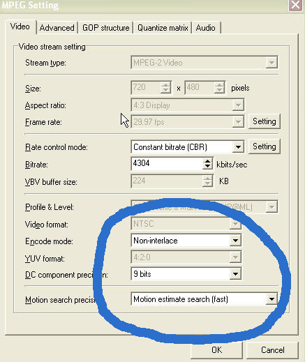

    Actually that image you post there andyp1 is when you have imported a 29.970fps non-interlaced source.

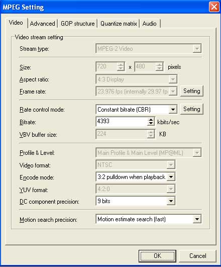

    If you load a 23.976fps progressive source then it looks a bit different:
    Notice the difference here with the FRAME RATE setting and the ENCODE MODE setting.
    Also I should point out that 10-bit should be used for the DC COMPONENT PRECISION setting. Also for MOTION SEARCH PRECISION I prefer to use the setting called HIGH QUALITY (SLOW) instead of the default (as seen in both my picture and andyp1's picture).

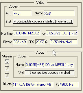

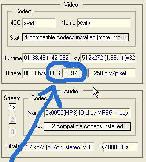

    I was sure it was 23.976fps.
    This is what gspot and avicodec say about the source
    I just opened it in the DVD NTSC template
    They both say 23.976

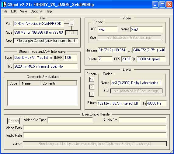

    I don't understand why my screen shots of TMPGEnc differ from those by andyp1 so here is the GSpot info of the file I used.
    This was a Xvid I created myself using a DVD rip of my NTSC DVD of JASON VS FREDDY. The DVD was PROGRESSIVE so I used DVD2AVI with the FORCE FILM option. Then I loaded the D2V into VirtualDubMod via a simple AvSynth script and saved it there was an Xvid AVI file.
