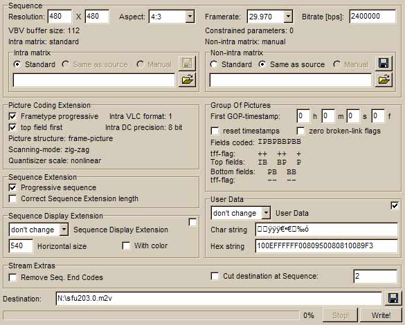

    I ask this question because I have 2 MPEG2 files....after authoring to DVD with DVD Author, one makes my standalone DVD choke (jerks, freezes, audio-synch) and the other looks just fine. Using Restream, the one that makes my DVD choke looks like:

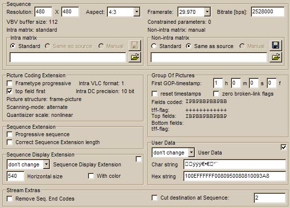

    while the good one looks like:
    when I demultiplex the VOB authored from the bad mpg and check with ReStream, I notice that TDA has switched the sequence label from prog to int. furthermore, when playing the VOB on the computer, it exhibits the same bad behavior. However, by just remultiplexing the VOB with TMPGEnc, the bad VOB can be turned into a good MPG...
    I've authored lots of sVCD to DVD using DVD Author, and this is the first time that I've seen something like this. I think the flags are just wrong in the first place...but I don't know the best way to fix it. If I take the bad mpg, change both frames and sequence to interlace, and *then* author with DVD Author, I get a VOB which plays well on the computer (don't know about the standalone yet). In fact, just changing the sequence does the trick. But why? Maybe you think the sequence tag is meaningless, but DVDAuthor certainly does something differently, depending on its state.

    Look at the "fields coded" . It's not right

    i see the TFF flag alternating every 2 frames. this is standard for a MPEG2 stream which has had 3:2 pulldown performed, right? I don't know what this implies about the sequence and frame tags, though. You can't apply 3:2 pulldown to a frame-based encoding, right?
    And as a related question, I'm still not sure when you should mark the sequence as interlace and the frames as progressive.

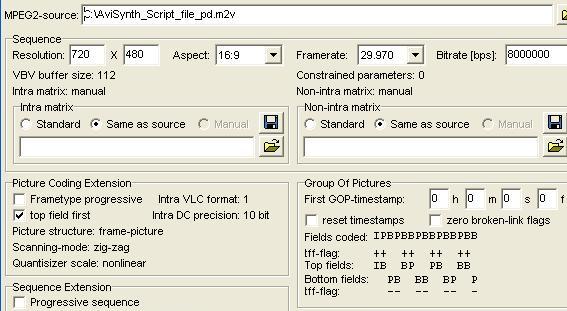

  9. Член BJ_M's Avatar
    Jul 2002
    Canada
    example of what correct pulldown looks like in restream
