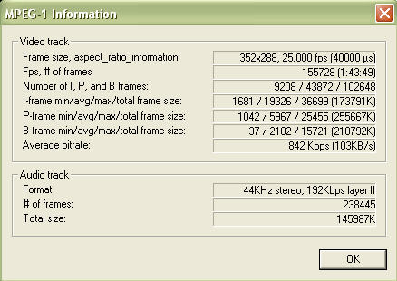

VCD framerate is normally 1150fps. I notice that the framerate of your file is 726fps .
That would be about right for a non-standard or xvcd of about 645M for 1h 35m so in terms of file size and movie length I would say it is about right.
I have a file similar to this size ill just have a quick play around with it and get back. -

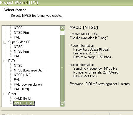

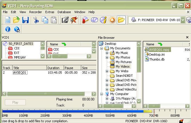

Right here we go couple of pic so give me chance to get them in first.
Looks surprisingly similar to yours doesn't it. Except that mine fits on the disc.
What seems to be happening there is that nerovision express doesn't see it as avcd compatible mpg and is atempting to reencode it which it will try to do . And it will do it at a bitrate of 1150fps which would make the file around 1GB for 1h 35m film.
I would reencode it with TMPGenc as an xvcd it may just have a messed up header but I dont know about that .

Do you know how to create a vcd file using TMPGenc ?
You need to create a new template for xvcd so you can reduce the bitrate which is something you cannot do in the standard templates , see pic

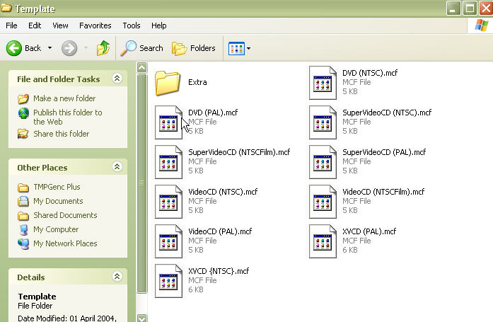

Well hopefully you have the templates by now.
To get them in the right place do this
Click - ill just do the steps - start - my computer - C Drive - program files - TMPGencPlus - Templates
Copy and paste or drop the files into that folder (thats it) it should now lok like this
Then if you close that down - open TMPGencPlus - Hopefully it will look like mine. -
