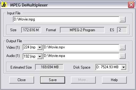

    Are you sure you are de-multiplexing first? The window looks like this:
    You can try and figure out the audio differential by opening the mpeg with Virtualdub MPEG2. Go to File>File Information and look at the audio and video time lengths. If they both match, you pretty much have to guess on your own. Keep experimenting and you'll get it.
