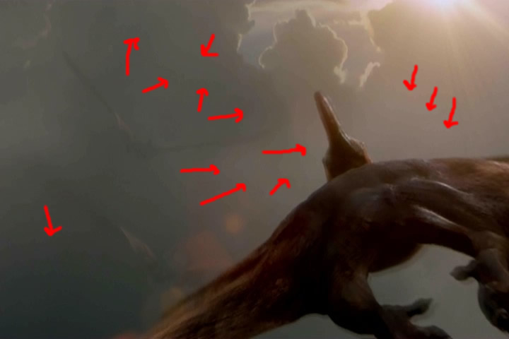

    Everytime I try to convert VOB to AVI with DVD2AVI, the final result is excellent. On the other hand, as soon as I edit the AVI file and re-render as MPEG2, I get some bandings. Take a look at this exemple:
    - Single AVI files can be rendered with TMPGENC using its inverse telecine option, works great (no banding anymore).
    - these MPEG files, previously rendered with TMPGENC (AVI to MPEG/m2v - inverse telecine), if edited on Vegas timeline and re-rendered again as MPEG files, bring the problem back again (banding).
    - Many edited AVI files (ex, on Vegas timeline) that make a whole project, if rendered this way as MPEG or m2v in TMPGENC, (from Vegas timeline tru Debugmode), even using TMPGENC's inverse telecine, give the same bad result = banding.
    Can anybody helpme please?
    Thanks in advance.

    The banding is caused by the transition from one color to the next. It's common when you reduce the color pallette of an image or video. It's caused by a jump over more than one color to get to the next nearest one and happens when you reduce the pallette from millions of colors to 16K colors or 256 colors, for example.
    Check your settings to see if you're limiting your colors in one of the steps.

    AVI, MPEG, DV are all quite different. Going from one to another isn't neccasarily lossless. You would be much better off working with the antive MPEG/VOB (MPEG's and VOB's are interchangeable, lossless conversion is easy) and not converting.
    Nowhere in your post do you specify the parameters of the intermediary AVI. That is, you converted to AVI, what codec? Frameserving with DVD2AVI isn't the same thing.
    What you are experiencing is fairly common. It can happen when you hit a 16-bit color scheme (some configurations DivX/XviD will do this). It can also happen changing your video from TV ready to computer. You TV can't display all the colors your computer can, but this usually shows up in black scenes.
    It can be from too low a bitrate also. Normally you see macroblocking, but if your shaving bits in a VBR pass, the background is a big fairly static space to steal from.

    Firstly, the purpose of DVD2AVI seems to let the created AVI being edited with Vegas or Premiere. LEt's take the following exemple that shows clearly what's happening.
    It's a simple thing I got a VOB file (from a commercial dvd - movie), just a small part of it, about 6 seconds.
    1.Open DVD2AVI>Open the VOB file>Choose Video:
    Video options:
    a)iDCT algorithm 32-bit SSE MMX
    b)Field Operation>Forced Film
    c)Color Space: RGB 24 bit (I've also tried YUV 4:2:2)
    e)YUV->RGB: TV or PC scale (doesn't matter)
    2.Save project as (name)
    3.Open VFAPI, create fake avi.
    4.Open Vegas, open fake avi, render as avi uncompressed or huffyuv.
    result = excellent AVI (Important: AVI properties = 23,976 fps IVTC FILM)
    Open this AVI on Vegas Timeline, edit, pan and crop (match output aspect and cut off back edges). Important: project properties (on the timeline) = NTSC DV 29, 970).
    After the editing process, render again as MPEG2 DVDA (for DVD architect) NTSC video stream, best resolution.
    Final quality = the picture above (lots of bandings)
    that's it.
