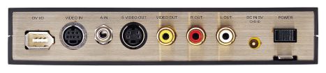

    Welx! You won't be disappointed in the Canopus ADVC-100. I use the video input & audio output on the back of the ADVC-100 and use the video in cable that came with the unit. When I first got mine I read in this forum using the backside of the unit was better than the front.
    Here's a picture of the backside of the unit:
