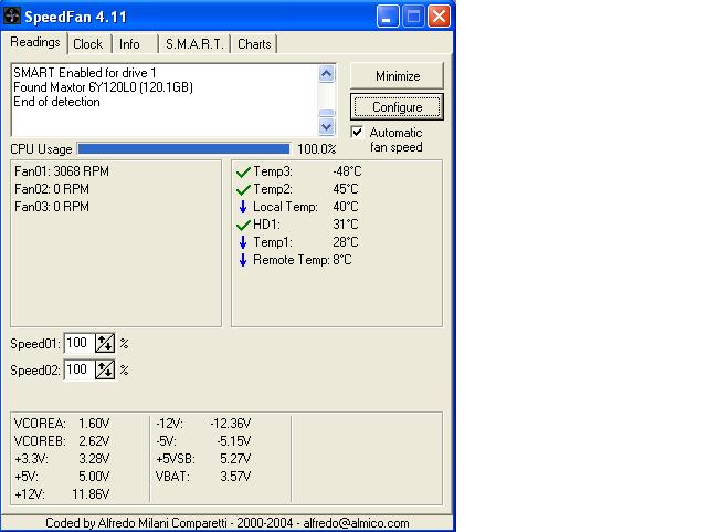

Haha...Adam you might have a point there. I've never had any issues with my system and instability but I did what you suggested. Here's my results:
Everything's running at about the same temps as always (those results are with prime95 running for about an hour). I just seem to have bad luck.

Yeah I don't see anything wrong with that, but maybe its not heat. Who knows it could be bad memory or a faulty hard drive or something. There are programs that can test both of those as well.
